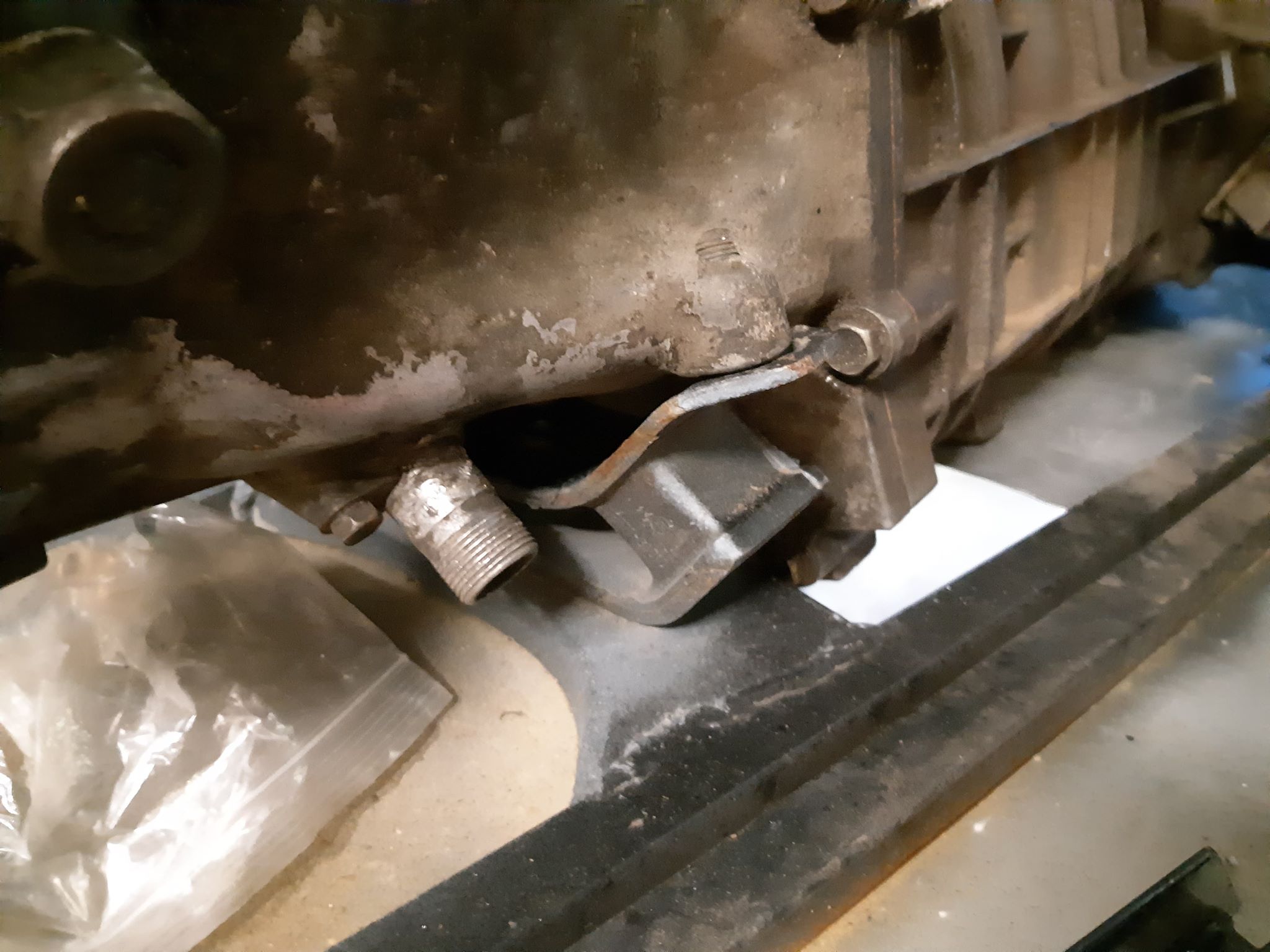

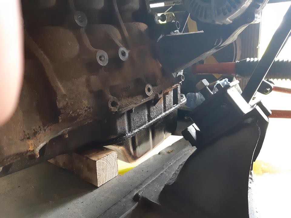

I closed the bottom ef the engine again and hoist it over and into the frame to see if was
made to fit.
Im using a Fwd exhaust headers, I dont own the Rwd one the engine came with a homemade at the
time which I put in the trash. So now I will have to make a turbo header, Oh well Laughing
The stock headers clear the brake booster but the line would not clear the headers coming from it.
I had planned to remove the brake booster and clutch master cylender and fabricate from them a raceing petal
makanism (Turn them 180°) to lower the two resovoir close to the bottom of the frame to make clear for
the turbo stuff but mainly to get the gear leaver closer to the driver, the hole engine and trans could
go back 5-6cm but I will check on that later.

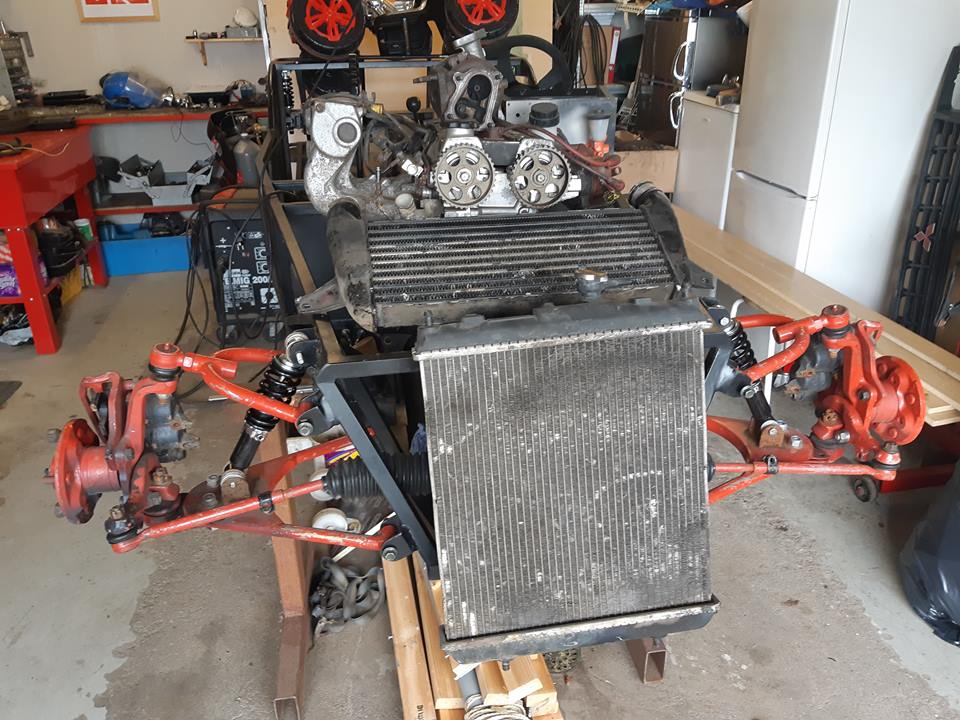

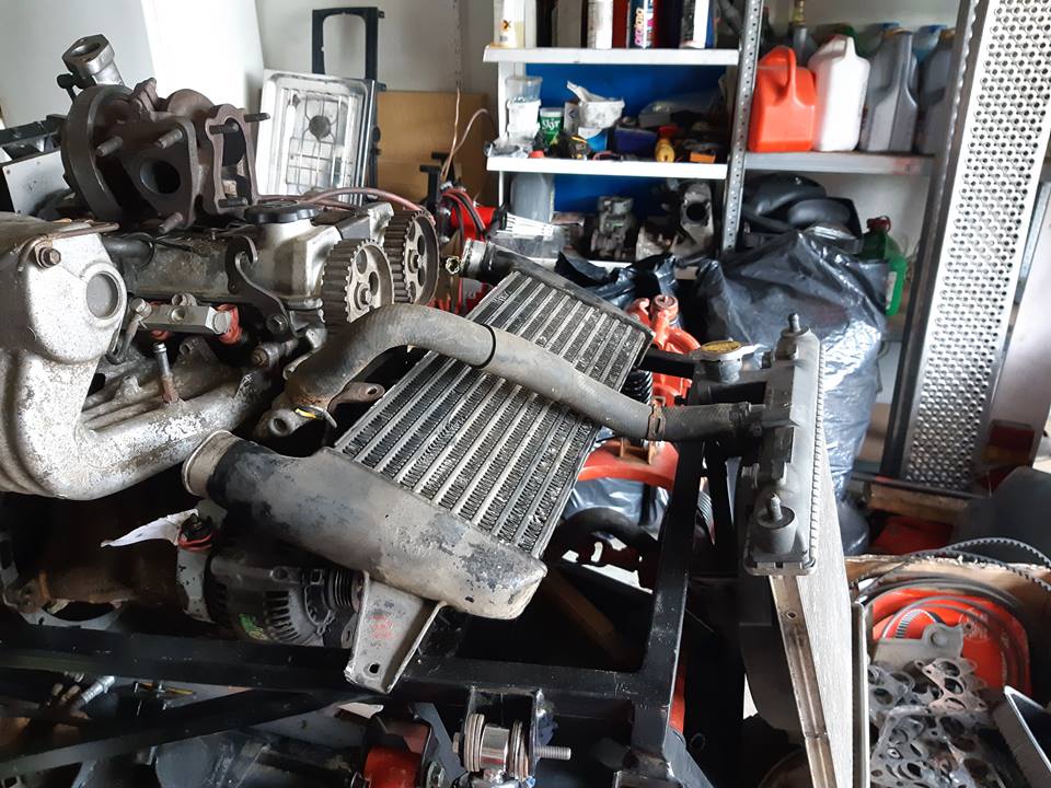

Put the front facing intake plenum on and its almost in-line with the EVO intercooler outlet port.
Now I need a small rad, thinking about a civic one.

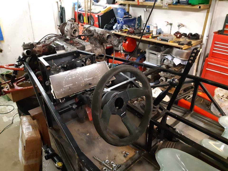

Been test fitting my self behind the wheel, in a position im confortable  in my knee is hitting the
steering wheel, so I moved the steering tube up about 3cm but still hitting the wheel needed like 1cm
more clearance the suade steering wheel is 350mm
I almoast bought a 320mm wheel online yesterday but thought I wait and see I might need to move
all of the steering and petals back about 30cm but as I was walking my kid to sleep in his stroller out side
I walked past the Mighty L200 and found a doner to fix this problem  laugh  totally for got I had 320mm
OMP steering wheel in it so now that problem is fixed, (for now)

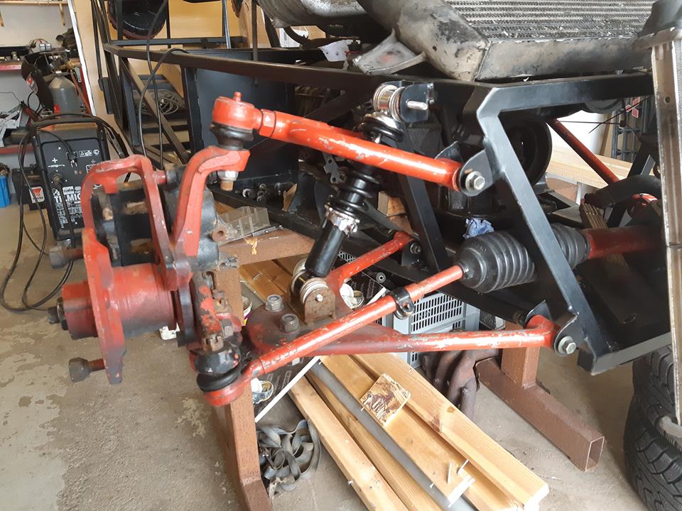

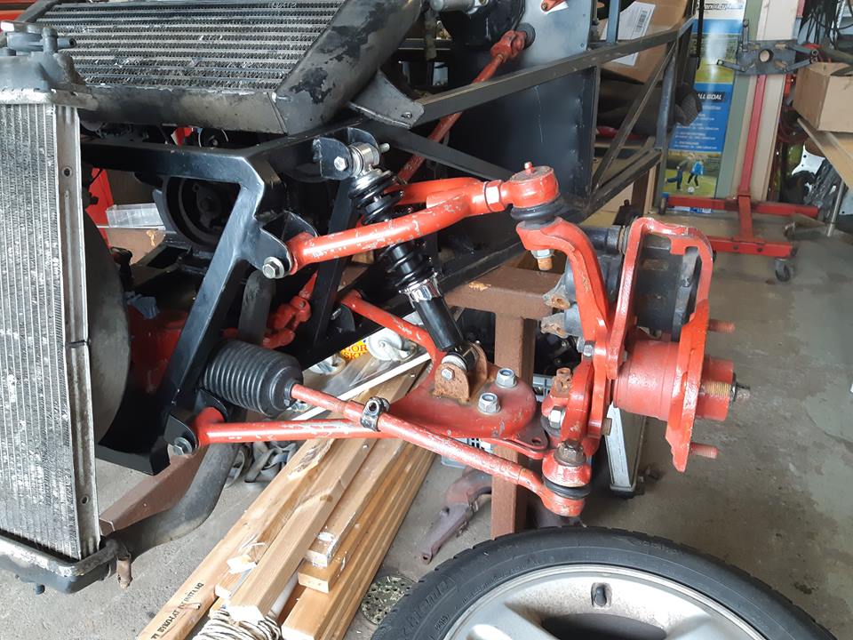

I Bought two new AE86 motor mounts, the frame already came with a new tranny mount Wink

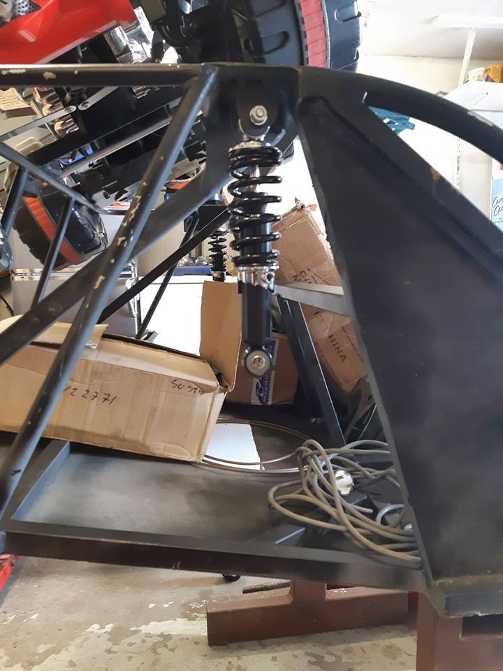

I also got new suspension extremely cheap from China but will probably buy new
and more addvansed suspesion with more flex. Also got a used radiator from Nissan Micra
Bought 4 shocks with 300lbs springs settup, in total delivered to my door around 140$ usa.
In the rear they are to short but could fab a steel welded to the rear axle with many adjustment
holes to make up the 10cm shorter suspension just to make this work for a couple of runs.

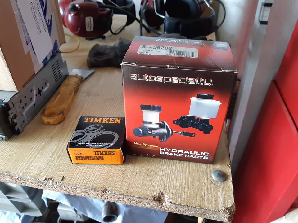

I  got another package, new pilot bearring and a clutch slave cylender for the T50 gearbox
Then dug out my OMP seat belts, I also hat new Atlas 3" seatbelts but cant find them anywhere
but 3" might be overkill, my two boys love the frame build spesially my 7year old Cool

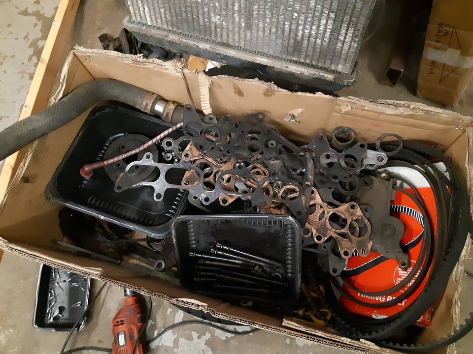

Then I went to my Toyota parts garage to look for stuff I could use in the frame, and somewhere
behind my fathers jeep Tires I found a dash that looks to be from a AE86.

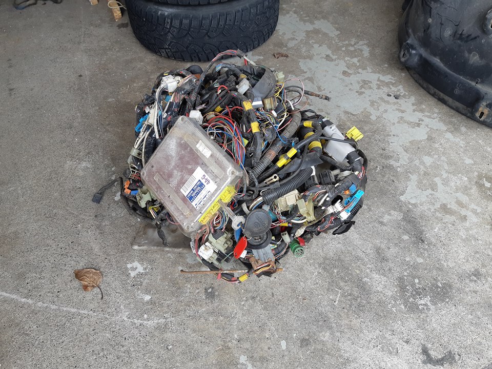

So if the dash was there I suspect I have the harness for it also, and hour later I found it
complete in-car and engine harness from a AE86 Buja!!
Nice big lump of wires
I also needed radiator hoses and clutch and flywheel for 6bolt 4afe or 7afe (if I go 7age)
also found a clutch fork that I needed the most cus I cant find it on ebay or Rockauto.com

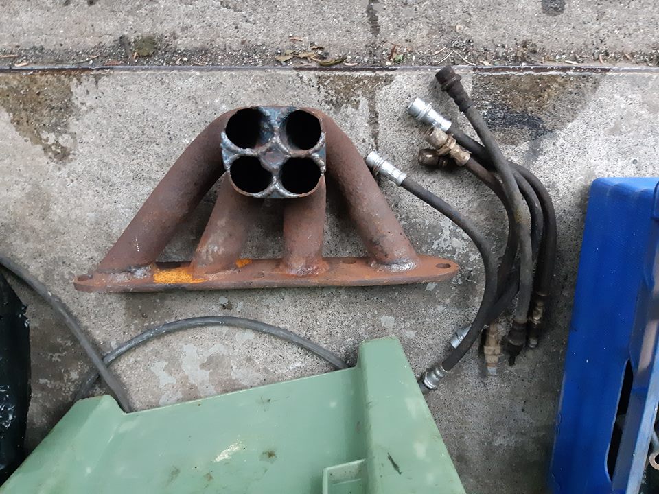

Then in all of the crap I found a beginning of a turbo hedders that I suspect that at one time
it was a complete headders 4-1, that would had been nice to have uncut on the engine Mad
