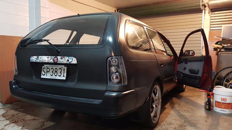

Valentines day present, aftermarket tail lights. Had to change the OEM lamp holders for the aftermarket ones, changed the bulbs to amber and red bulbs for the indicators/ brake light respectively.
On going moisture problems, need to take them off the car for the 4th time to get a permanent fix for the grommet leaks.

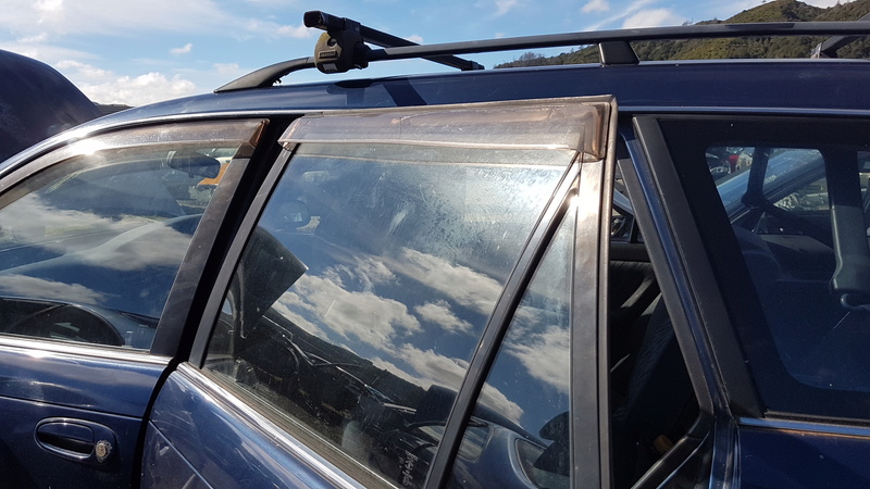

Went to the local wreckers again, found a GT wagon, got the spoiler for a mate, bought the roof racks and monsoon guards. had to clean them up quite a bit, resprayed the racks with black and then gloss clear. Repaired the monsoon guards as much as I could, making them look consistent and re-glossed them after a thorough clean.

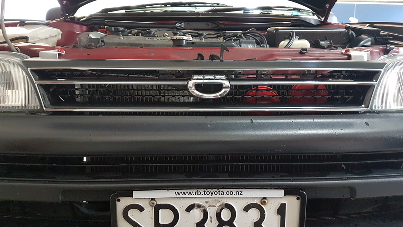

New grill, I love the iconic Corolla crown instead of the toyota emblem, took my time over the course of a couple weeks sanding down the plastic, scrubbing back the chrome with tin foil (aluminium foil) to clean it up, masked it while watching movies in the background which took a while with masking tape and scalpel, sprayed with black and gloss, took the masking off.

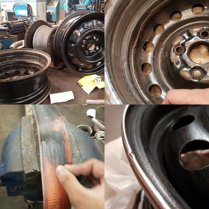

Hated how the 17s looked with the 14s, so i sold the 17s. Swapped my steelies tyres onto the Enkei Rp01 14"s, cleaned the steelies, sanded, flap sanded the edges for a nice polished look on the edge. I prefer this than using chrome lips which would visually contract the space around it, making it look smaller than it already looks, also makes it rugged! Masked the edge and pressure valve ends, rubbed down with wax & grease remover, sprayed with self etching primer cause some of my sanding took it to bare metal, then rustoleum matt black paint+primer 2 in 1 for the base coat, then gloss clear.
I feel adding matt black, then gloss clear gives a much nicer shine than gloss black.
