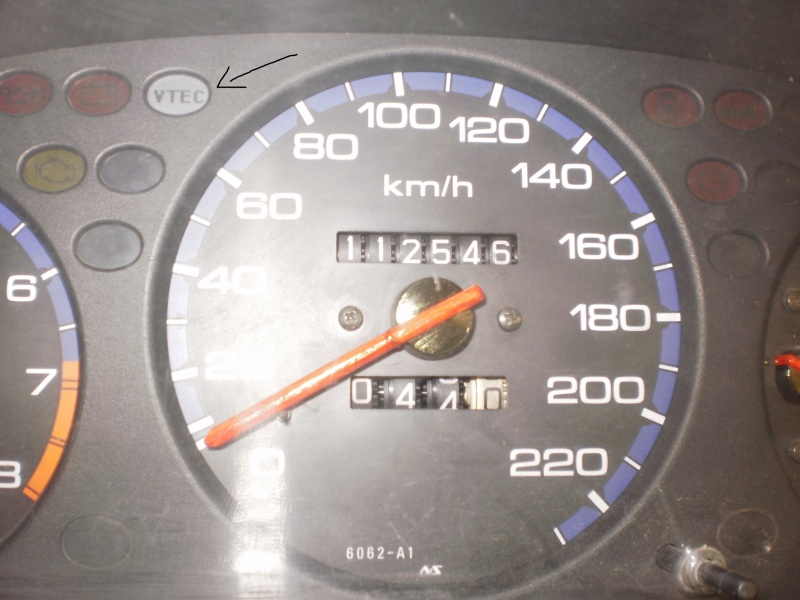

ohhh my engine produces 120 bhp goodie and bro i recently got my civics engine repaired twice in these 3 months the oil pump stopped working and the crank was damaged and the main bigens also.so i had to put new rings new bigens turned the crank to 10 and had to bore my block and installed newand bigger pistons.
so i think i will not go for the bigger engine im just gonna sell my car soon to make my ae101 better and ps i have also did a diy on my civic for the vtec light when ever my car goes above 3000 rpm the light comes on saying vtec and when it goes below 3 rpm it turns off pretty neat tooo let me show u the pic

hmmm.. you know you could just slam in a new d15b vtec engine in your honda, would fit nicely with out conversion. and cheaper than doing the overhaul. i think i have one of those vtec light installed. its just tapped to the vtec and the ecu.. but didnt think of putting it in the gauge.

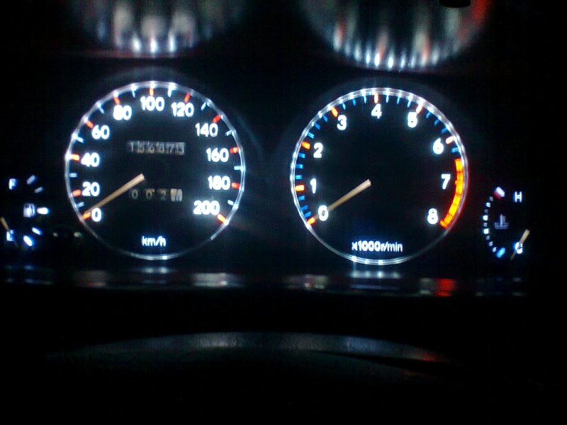

are those led's on your rolla gauge?

those leds were in my white rolla it had the same engine as yours its pictures re on the first page of my build thread u should check that out

but the corolla meter had about 120 to 130 flat faced white leds super glued to the transparent frame .a pair of leds were connected by one resister aproxx 70 to 80 resistors were used.and the blue and red shade was given to the leds by colouring the plated blue and red from behind by a colour marker.
the meter was of 2500 25 us dollars
total amount of leds my bro bought were 200 was 2 rupees apiece thats 400 means 4 dollars
total resistors were 100 those were of 150 rs
two soldering wire rolls 200 rs
approx time in making this was 7 sleepless night
but in the end it was some thing unique
the wiring was done by brother hes the engineer so will tell him to do that
as for the vtec light i took a yellow coloured paper typed small words vtec on in by printer
pasted it on the meter added a bulb with holder on the back then i found the vtec function wire solenoid in the ecu.removed some of the wires plastic cover and attatched the positive wire from the bulp into the ecu vtec solenoid and attatched the negative wire to the rpm meters current its really simple and help alot u could always know when all your valves are running and when u want to save gas you would know that you wont want to turn that light on.
