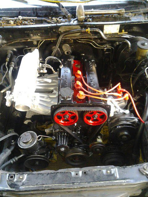

YEAH THIS ONE >>> 4A-GE 16V TWINCAM IN A AE101?? 4a-ge_10

Oh that is a bit different... never mind then LOL

HAHAHA IGHT... MAYBE I SHOULD PUT THE PIC BEFORE HAHA
4A-GE 16V TWINCAM IN A AE101?? Empty
PostSubject: Re: 4A-GE 16V TWINCAM IN A AE101??   4A-GE 16V TWINCAM IN A AE101?? EmptySun Dec 30, 2012 11:13 am
yes, good idea for next time Razz
