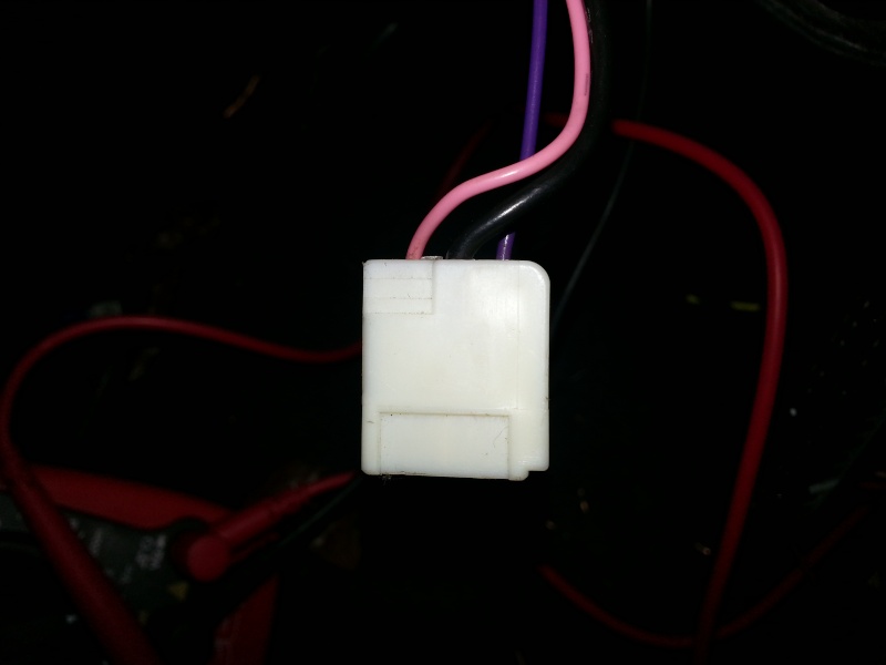

Ok i have the large plug repinned and the car goes to fire up but then it seems to cut fuel,my pump is priming and im getting spark.My open circuit relay and efi main relay are both working also.The small 3 pin plug below is the only one i have left but but there is no corrisponding wires for it.I have a suspicion it may be for some kind immobiliser or something but i dont have a chipped key.My car is 1996 and a friend told me 95 onwards have some kind off immobiliser in them.His 1993 corolla is the exact same loom as mine except it doesnt have this 3 pin plug.Anyway here's a pic.
[img]5afe interior loom and 4efe engine loom 20130311[/img]
[img]5afe interior loom and 4efe engine loom 20130312[/img]

The black wire turned out to be the permanent power for the injectors which is then earthed through the ecu each time the crank signal is picked up,the other pink and purple wire was for a the radio which was weird but i didn't have to use them as the radio is powered through the 5afe harness.
