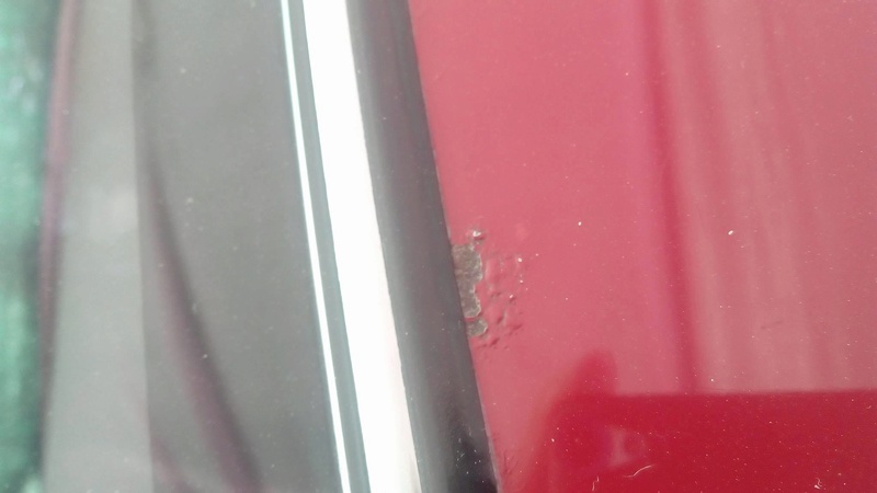

Rust Empty
PostSubject: Re: Rust   Rust EmptyMon Mar 06, 2017 5:11 am
In my case there is a little rust but I dont know what to do?Rust 17148710
