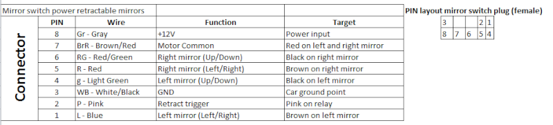

The wiring on the mirrors
Power retractable (folding) JDM mirror wiring Mirror13
The mirror switch pinout
Power retractable (folding) JDM mirror wiring Mirror11
Some extra info, the mirrors don't have two motor for the retract/extend functions. The polarity make them either retract or extend. Motor A is connection A and motor B is connection B, there's officially not called A and B, but I've used it to clarify things.
The mirror relay pinout
Power retractable (folding) JDM mirror wiring Mirror14
The layout ain't as sweet as previous pinouts, but it works I guess Smile

I know there are still wires missing, I will be adding those once I have finished my research

That's all folks! Just uploaded the new (and complete) diagrams in the startpost...
An excel file with the complete diagram (instead of separate images) can be sent on request.

I'll have a better look in the wiring diagrams when I get home but I don't think our Aus-made Corollas have a standalone relay for the power mirrors, everything was controlled within the switch (since we didn't have retractables) and just got a single fused Acc power feed.
Looking at Sgt_Lyna's pinouts on the front page, there shouldn't be a problem as the relay box you got with the mirrors just needs switched power and ground, so really you're replacing the existing all-in-one mirror switch with a new switch and a standalone relay.

Oh and here on this datasheet it says " Power before or after ignition", is it the same is normal 12V?
Power retractable (folding) JDM mirror wiring 3580tco

anyone can help me? I god power folding mirrors with only 6 pins... the graph above says the mirrors has 8!!! any help will be greatly appreciated... thanks...
