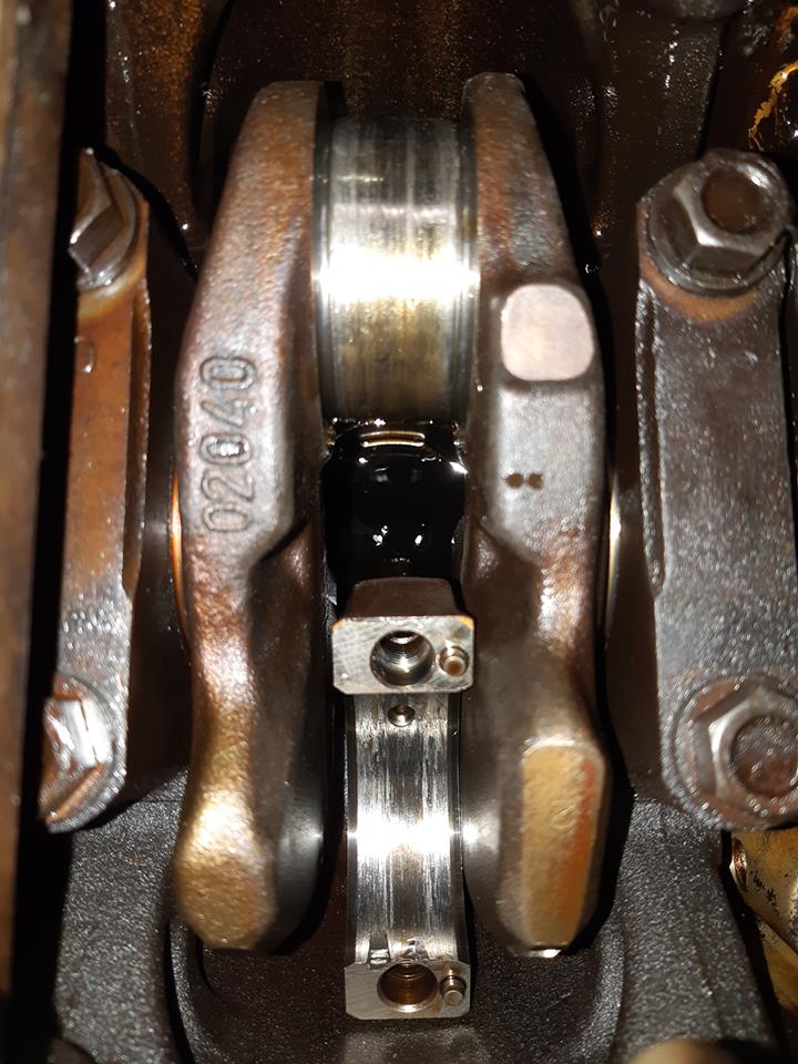

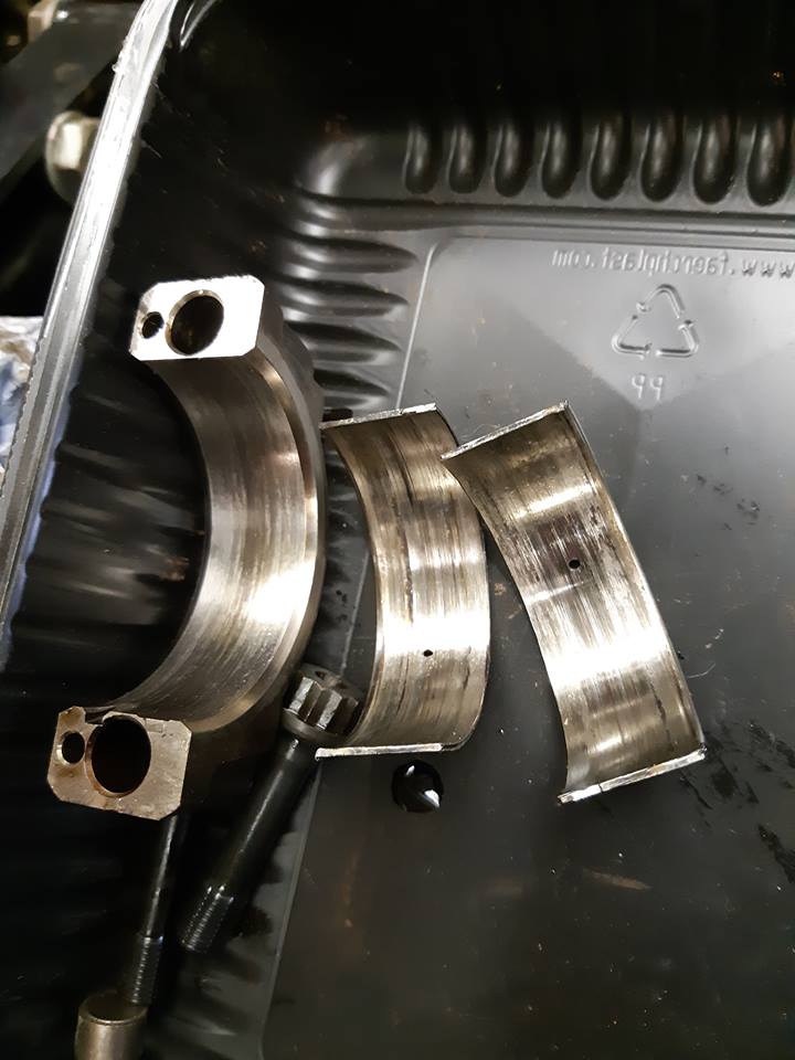

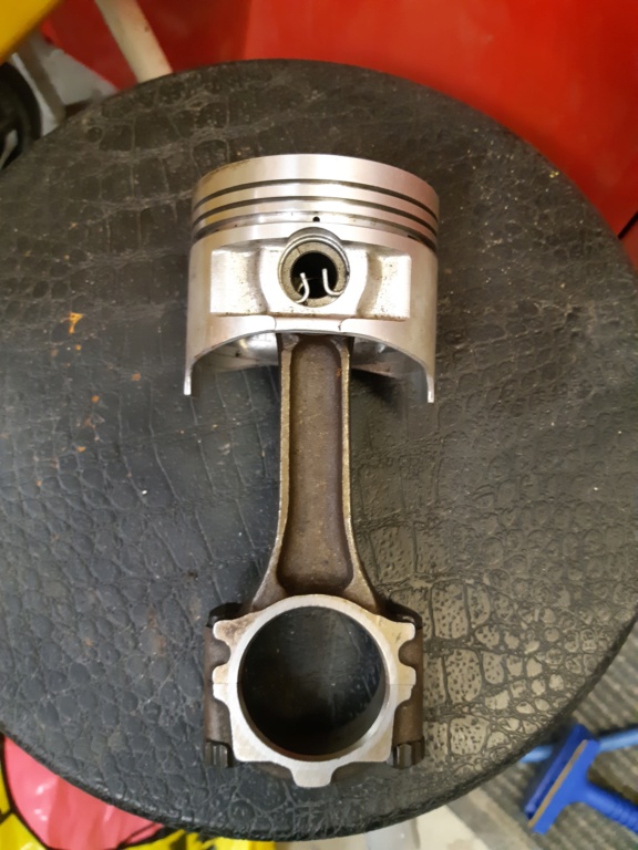

I turned over the 7age engine I had in the garage, been standing for a year now and I had marked it nr.1
Thought it was the one that blew valve seals or a piston ring, so I opened the oilpan to see if it was
the same engine...
Just another corolla - DIY Caterham frame 7age and ´93 Liftback RWD - Page 9 7a10
Just another corolla - DIY Caterham frame 7age and ´93 Liftback RWD - Page 9 7a210
Just another corolla - DIY Caterham frame 7age and ´93 Liftback RWD - Page 9 7a410
Just another corolla - DIY Caterham frame 7age and ´93 Liftback RWD - Page 9 7a310

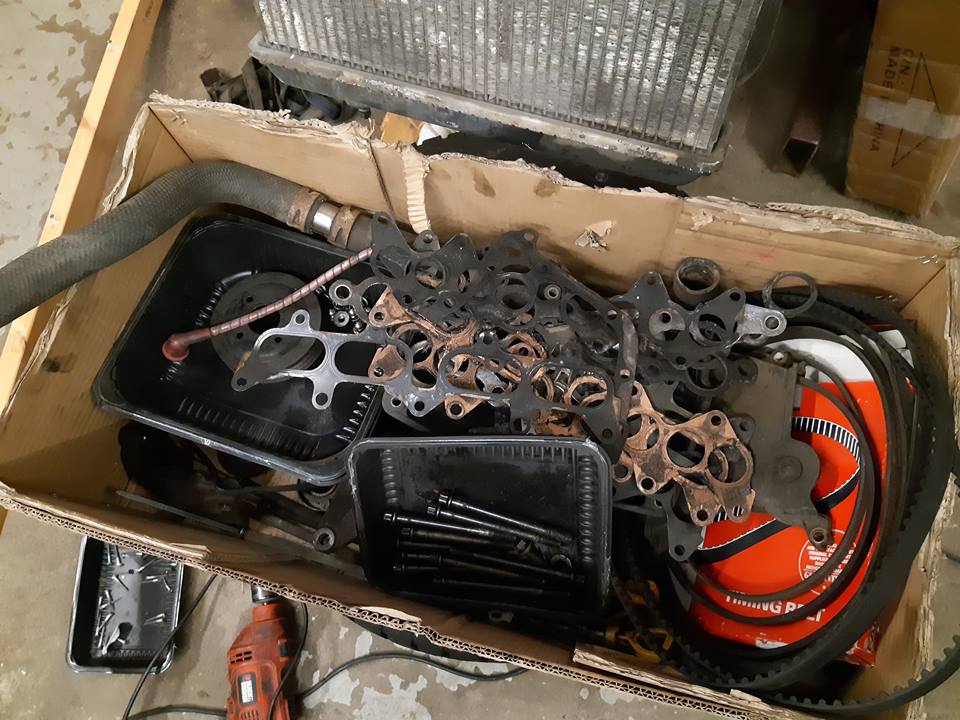

That was a quick let down, now I got to tear it apart and change the rod that is busted, might aswell
go all the way then and order rings and bearrings and make it new again. but this time I will buy a
crank shaft timing belt sprokket made for the 7age so I dont need to adjust the cams for timing.
But I wont have to think as much about this now see as it is a rebuild project not a runner.
Going for the stock 4age engine I have in the Toyota parts garage, good to have extra stuff sometimes.

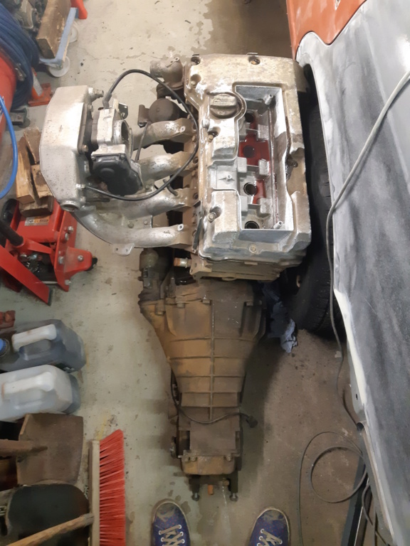

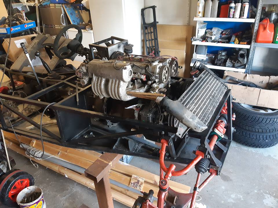

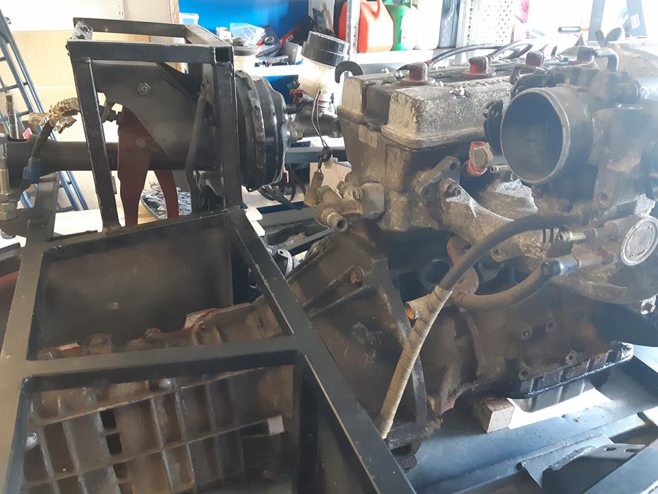

I closed the bottom ef the engine again and hoist it over and into the frame to see if was
made to fit.
Just another corolla - DIY Caterham frame 7age and ´93 Liftback RWD - Page 9 33899610
Im using a Fwd exhaust headers, I dont own the Rwd one the engine came with a homemade at the
time which I put in the trash. So now I will have to make a turbo header, Oh well Laughing

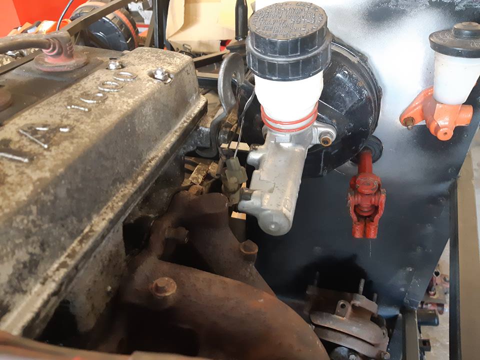

The stock headers clear the brake booster but the line would not clear the headers coming from it.
Just another corolla - DIY Caterham frame 7age and ´93 Liftback RWD - Page 9 34030010
I had planned to remove the brake booster and clutch master cylender and fabricate from them a raceing petal
makanism (Turn them 180°) to lower the two resovoir close to the bottom of the frame to make clear for
the turbo stuff but mainly to get the gear leaver closer to the driver, the hole engine and trans could
go back 5-6cm but I will check on that later.

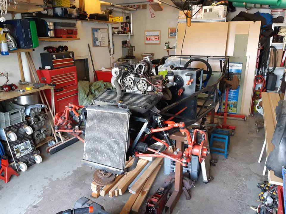

Put the front facing intake plenum on and its almost in-line with the EVO intercooler outlet port.
Just another corolla - DIY Caterham frame 7age and ´93 Liftback RWD - Page 9 33922810
Now I need a small rad, thinking about a civic one.

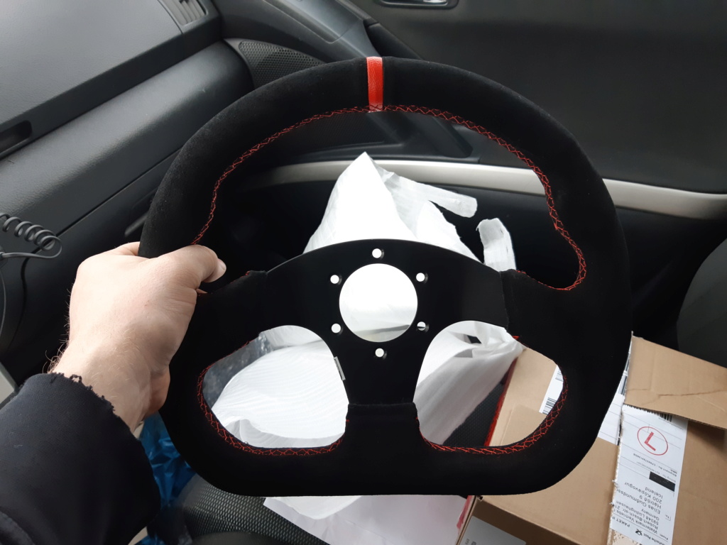

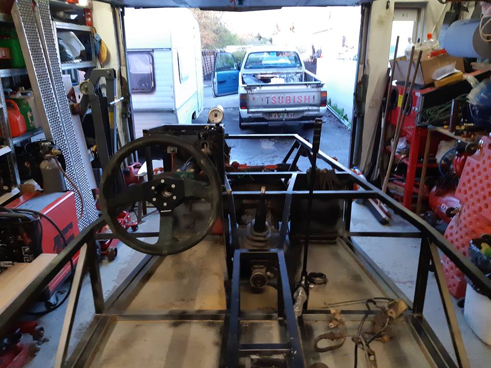

Been test fitting my self behind the wheel, in a position im confortable  in my knee is hitting the
steering wheel, so I moved the steering tube up about 3cm but still hitting the wheel needed like 1cm
more clearance the suade steering wheel is 350mm
Just another corolla - DIY Caterham frame 7age and ´93 Liftback RWD - Page 9 33404412
I almoast bought a 320mm wheel online yesterday but thought I wait and see I might need to move
all of the steering and petals back about 30cm but as I was walking my kid to sleep in his stroller out side
I walked past the Mighty L200 and found a doner to fix this problem  laugh  totally for got I had 320mm
OMP steering wheel in it so now that problem is fixed, (for now)
Just another corolla - DIY Caterham frame 7age and ´93 Liftback RWD - Page 9 Omp10

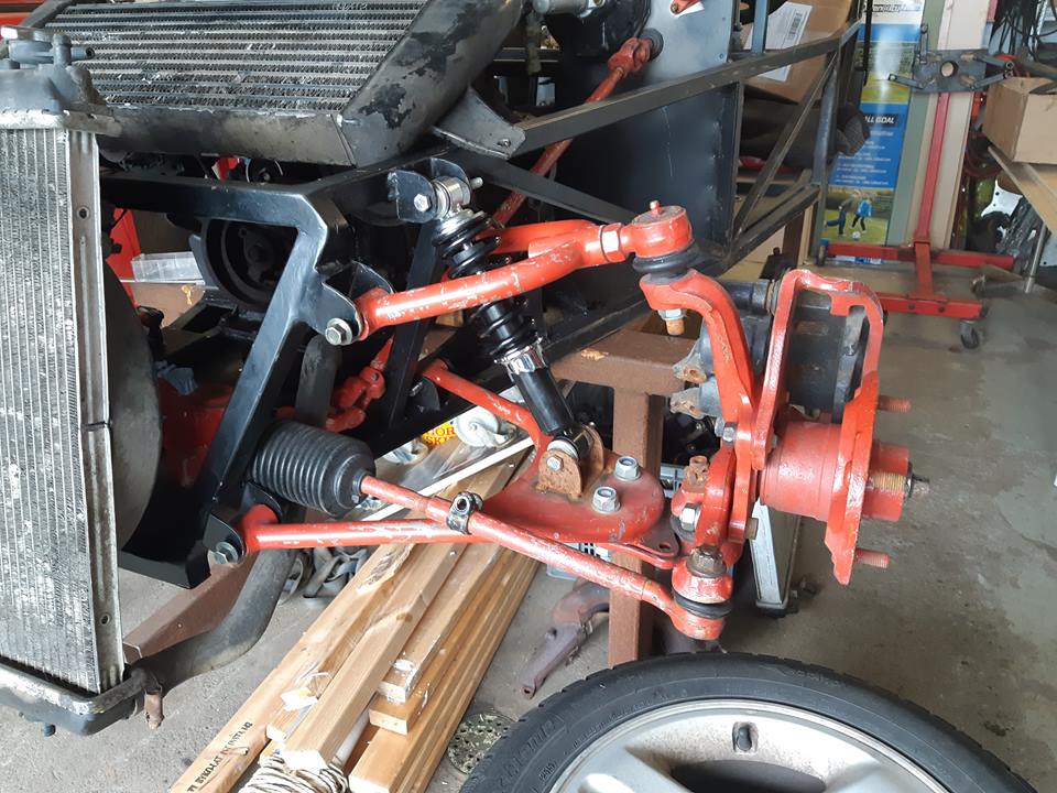

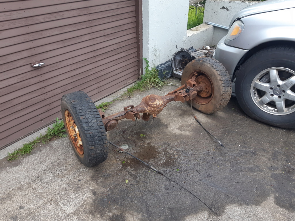

Found more stuff I could do befor finding time to pick up and part the 4wd Corolla
I went on my favorite online part website Rockauto.com been buyin all my car parts there for two
years now, i have a ML500 4WD Mercedes that I have little by little parting all togeather with new stuff.
I Bought two new AE86 motor mounts, the frame already came with a new tranny mount Wink
Just another corolla - DIY Caterham frame 7age and ´93 Liftback RWD - Page 9 34725110
Just another corolla - DIY Caterham frame 7age and ´93 Liftback RWD - Page 9 34847110
Just another corolla - DIY Caterham frame 7age and ´93 Liftback RWD - Page 9 34777510

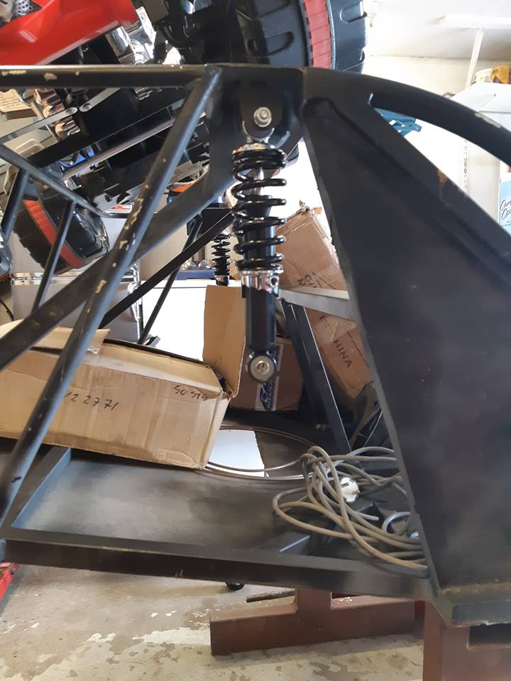

I also got new suspension extremely cheap from China but will probably buy new
and more addvansed suspesion with more flex. Also got a used radiator from Nissan Micra
Just another corolla - DIY Caterham frame 7age and ´93 Liftback RWD - Page 9 34810011
Just another corolla - DIY Caterham frame 7age and ´93 Liftback RWD - Page 9 34790110Just another corolla - DIY Caterham frame 7age and ´93 Liftback RWD - Page 9 34748210

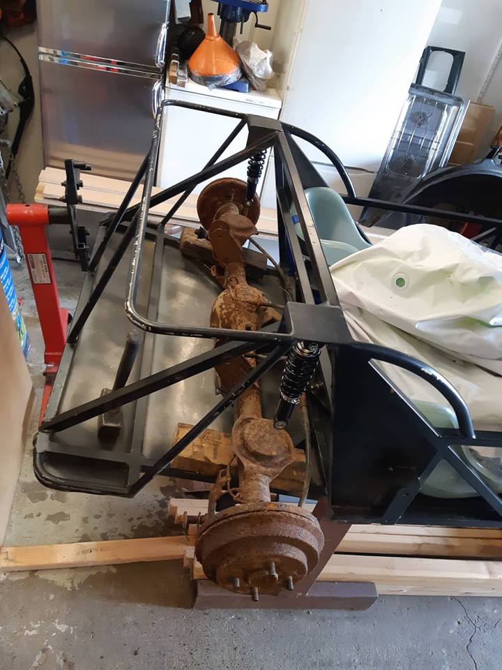

Bought 4 shocks with 300lbs springs settup, in total delivered to my door around 140$ usa.
In the rear they are to short but could fab a steel welded to the rear axle with many adjustment
holes to make up the 10cm shorter suspension just to make this work for a couple of runs.

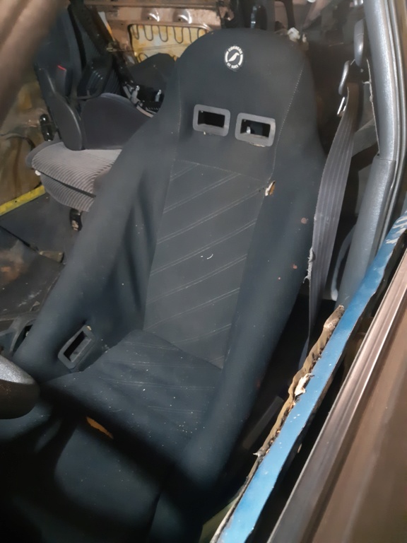

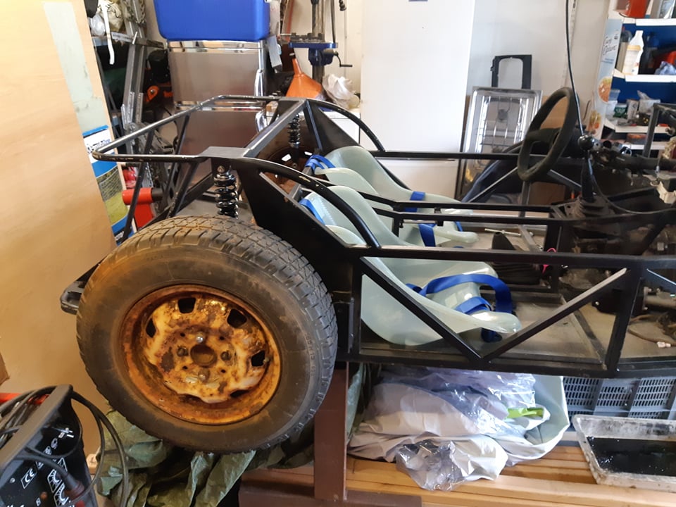

New stuff arrived!
Just another corolla - DIY Caterham frame 7age and ´93 Liftback RWD - Page 9 Tillet17
Bought new Gokart seats from Tillett Racing
Just another corolla - DIY Caterham frame 7age and ´93 Liftback RWD - Page 9 Tillet13
They fit me like a glove
Just another corolla - DIY Caterham frame 7age and ´93 Liftback RWD - Page 9 Tillet18
Just another corolla - DIY Caterham frame 7age and ´93 Liftback RWD - Page 9 Tillet19
Just another corolla - DIY Caterham frame 7age and ´93 Liftback RWD - Page 9 Tillet20
Just another corolla - DIY Caterham frame 7age and ´93 Liftback RWD - Page 9 Tillet21
Fitted them in the frame, they fit like a glove there to, love when this happens
Just another corolla - DIY Caterham frame 7age and ´93 Liftback RWD - Page 9 Tillet23
Just another corolla - DIY Caterham frame 7age and ´93 Liftback RWD - Page 9 Tillet22
Just another corolla - DIY Caterham frame 7age and ´93 Liftback RWD - Page 9 Tillet25
Just another corolla - DIY Caterham frame 7age and ´93 Liftback RWD - Page 9 Tillet26
My doughter had to pose  king
Just another corolla - DIY Caterham frame 7age and ´93 Liftback RWD - Page 9 Tillet24
Cant wait to bolt them in how ever i am going to do that task.

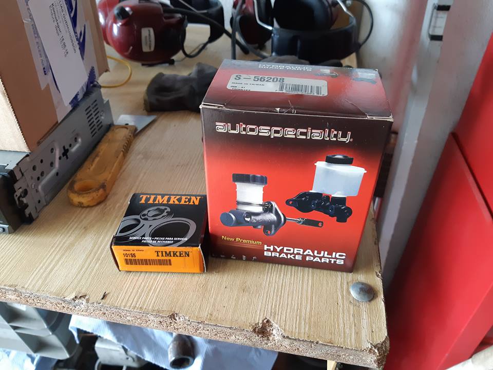

I  got another package, new pilot bearring and a clutch slave cylender for the T50 gearbox
Just another corolla - DIY Caterham frame 7age and ´93 Liftback RWD - Page 9 35398210

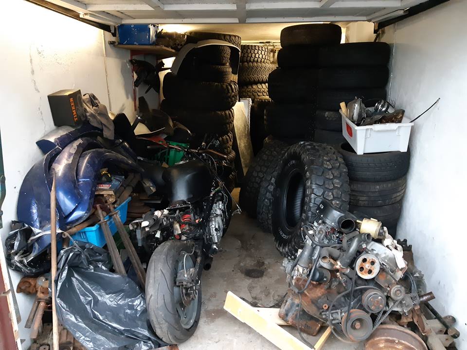

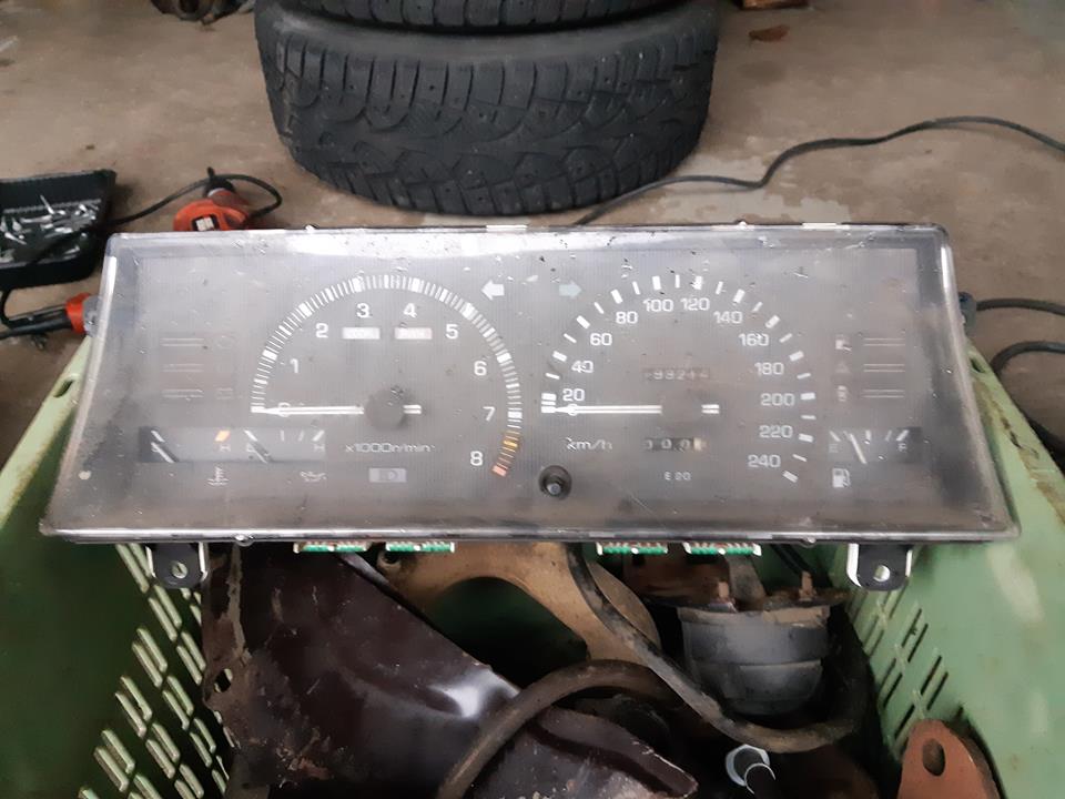

Then I went to my Toyota parts garage to look for stuff I could use in the frame, and somewhere
behind my fathers jeep Tires I found a dash that looks to be from a AE86.

I also needed radiator hoses and clutch and flywheel for 6bolt 4afe or 7afe (if I go 7age)
also found a clutch fork that I needed the most cus I cant find it on ebay or Rockauto.com
Then in all of the crap I found a beginning of a turbo hedders that I suspect that at one time
it was a complete headders 4-1, that would had been nice to have uncut on the engine Mad

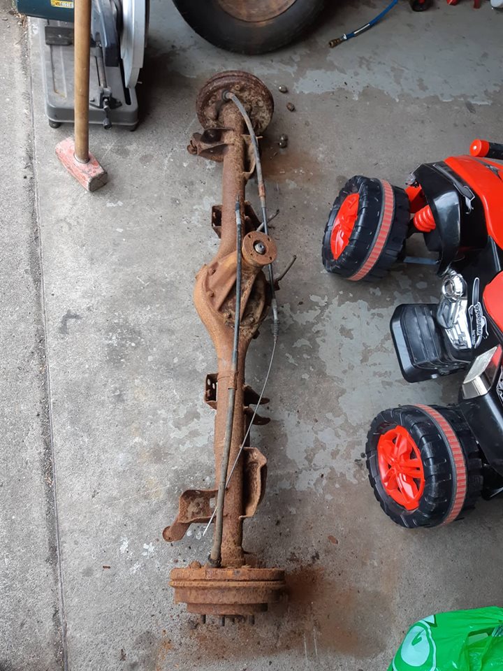

Desited to wait alittle longer to tear down that 4x4 Touring toyota Carib parts car, the little parts i still need now i can pull from pick and pull grave yard down town..
I put up an add on faxebook for a rear axle from the same model and got it the same day.
Just another corolla - DIY Caterham frame 7age and ´93 Liftback RWD - Page 9 20180710
Now i can start making the suspension parts and all the other stuff around the rear fitted so i can put the wheels on and have the frame stand on its own.

Finally found time to fit the rear axle in the frame.
First I had to cut the old panhard bars away and then unbolt the wheels.
Just another corolla - DIY Caterham frame 7age and ´93 Liftback RWD - Page 9 37106210
Then I picked up the whole rear axle and put it in the frame, these things are light!
Just another corolla - DIY Caterham frame 7age and ´93 Liftback RWD - Page 9 37183110
Just another corolla - DIY Caterham frame 7age and ´93 Liftback RWD - Page 9 37167410
Looking at the it from the front, I messured the front from hub to hub 140cm
and I think if I recall the rear was 145cm from hub to hub.

So to start where I last went off, I got some more Caterham stuff ordered, new headlight´s Suspension bushings
go kart seat shims and bolts, new suade steering wheel that clears my knees, gasket set for 4age and 7afe.

Finally found my big rod set that I had stored somewhere 10years ago they are 24mm
they are going into a 4agte build for the caterham or another project that I started working
on over at my toyota parts garage.

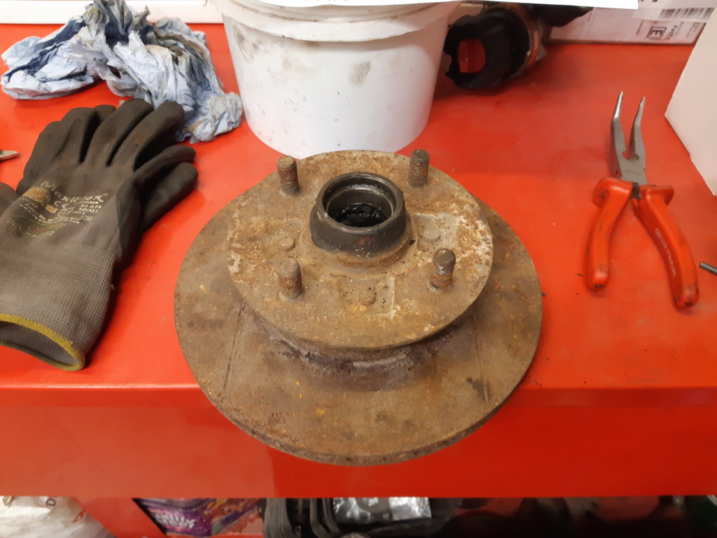

Then I started working on the front brakes, trying to find out what brand front calipers it
had was a no go, so I opted I change the front hubs for a set of AE86 front hubs with
calipers, brake disks and pads, currently still working on that part.

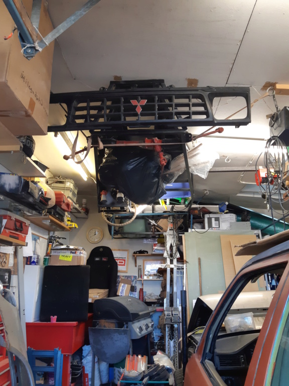

So that is cind off it for the Catherham build, I desited to buy new parts every month
to collect as many stuff for it as I could then when the time came I would bolt everything
to geather and have fun, mean while I strapped it to the roof of the garage so I could
to something else in the garage.

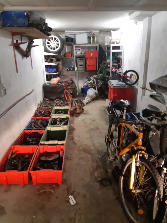

I just could not wait to start working on it so I took it to my Toyota Parts garage and just
cleared out the garage, every thing I could not sell the last two years I threw away and
every thing else I boxed and stored in the corner to make room for the car. I fixed the
broken water pump because I was going to start the project using the existing
engine (4afe) and a T50 AE86 gearbox and driveshaft.

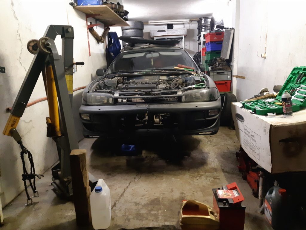

So there was nothing to do but start tearing everything out of the engine bay, every bolt.

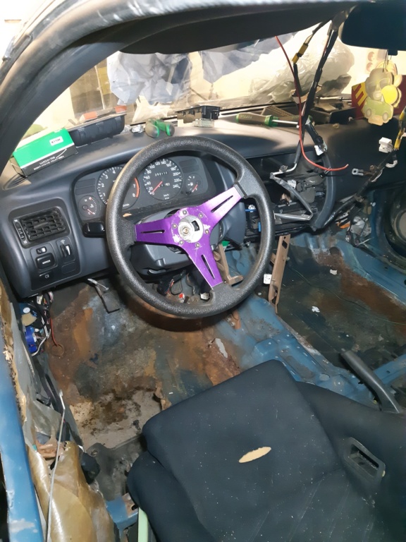

Cutting the floor and firewall
Just another corolla - DIY Caterham frame 7age and ´93 Liftback RWD - Page 9 20190321
Just another corolla - DIY Caterham frame 7age and ´93 Liftback RWD - Page 9 20190323
Just another corolla - DIY Caterham frame 7age and ´93 Liftback RWD - Page 9 20190322
So because I have extra EVERYTHING corolla related I recon I start by fitting
toyota stuff to it first, then later the Mercedes stuff if I desited to go that rout

Fits neatly, just have to cut a little more around the tunnel for the bell housing to clear
Just another corolla - DIY Caterham frame 7age and ´93 Liftback RWD - Page 9 20190327
Just another corolla - DIY Caterham frame 7age and ´93 Liftback RWD - Page 9 20190328
Next to fit a 4age engine block to see where i am at
Just another corolla - DIY Caterham frame 7age and ´93 Liftback RWD - Page 9 20190329
Just another corolla - DIY Caterham frame 7age and ´93 Liftback RWD - Page 9 20190331
Just another corolla - DIY Caterham frame 7age and ´93 Liftback RWD - Page 9 20190330
Just another corolla - DIY Caterham frame 7age and ´93 Liftback RWD - Page 9 20190333
Just another corolla - DIY Caterham frame 7age and ´93 Liftback RWD - Page 9 20190332
Jees the room in there, I could fit a v12 lol!  So next I swapped out the
left and right front hubs to get the power steering to fit under the oil pan
Just another corolla - DIY Caterham frame 7age and ´93 Liftback RWD - Page 9 20190334
Just another corolla - DIY Caterham frame 7age and ´93 Liftback RWD - Page 9 20190335
Just another corolla - DIY Caterham frame 7age and ´93 Liftback RWD - Page 9 20190336
Bolted up the oil pan and the power steering to the hubs and checked for clearance
Just another corolla - DIY Caterham frame 7age and ´93 Liftback RWD - Page 9 20190337
Just another corolla - DIY Caterham frame 7age and ´93 Liftback RWD - Page 9 20190338
Checked the steering angle
Just another corolla - DIY Caterham frame 7age and ´93 Liftback RWD - Page 9 20190339
Just another corolla - DIY Caterham frame 7age and ´93 Liftback RWD - Page 9 20190340
So this is just a work in progress, plan is to work on it only at night
when I cant sleep (happens alot) I think I already have a rear subframe
from one of my 4x4 Touring (BZ BRZ wagon 4x4) that I could bolt up but
I dont want to do that part again later if the diff and axles wont hold the power
so might go with the w124 mercedes rear subframe after all, only time will tell.
Just another corolla - DIY Caterham frame 7age and ´93 Liftback RWD - Page 9 20190341
Just another corolla - DIY Caterham frame 7age and ´93 Liftback RWD - Page 9 20190343
Just another corolla - DIY Caterham frame 7age and ´93 Liftback RWD - Page 9 20190342
Im out.
