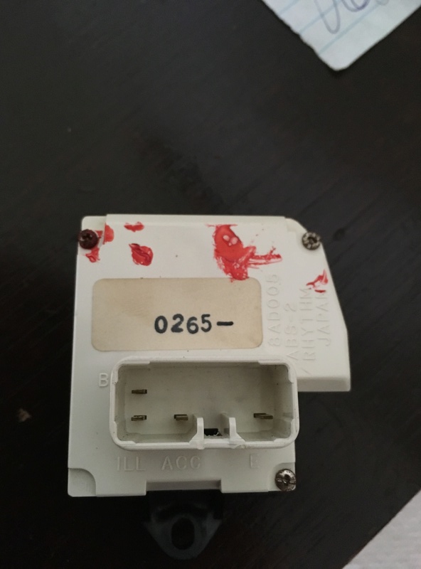

No luck so far. Lately I've been focusing more on general maintenance of my Corolla, although recently I installed four new speakers and an amplifier to work with the Graphic Equaliser. Getting all that to look and sound the best has been top priority for a little while now (I say top priority, although it's not very often that I do work on my Corolla. Little bits here and there when I can fit it in between other stuff).
kickfli12 wrote:
Can I have the clock vent? Ill ship you a usdm clock plug. It may be what you need
If possible that'd be much appreciated! It'll make the installation that much easier and I'd be very grateful. I'll attach a picture of the plug receptacle on my clock, as since the clock has an asymmetrical nook in it, there may be a discrepancy between RHD and LHD clock plugs.

Dash Clock for Australian AE101 Empty
PostSubject: Re: Dash Clock for Australian AE101   Dash Clock for Australian AE101 EmptySun Dec 25, 2016 11:13 am
Ill look around for a clock in my garage. They look the same based off my memory
