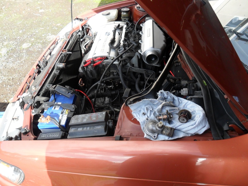

My high beam lights does not work, I suspect the relay is damage, but the diagram printed on the fuse box cover is all fade out, so, I cant tell which one is the high beam relay.
Anyone got the info?

You can't read what's on the fusebox, a closer picture is required!
