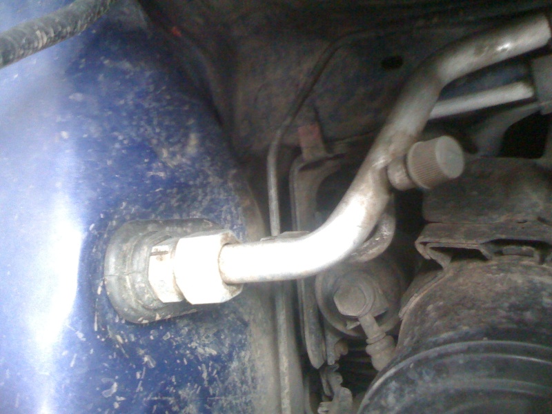

Hi i am looking to take my A/C (air conditioning) out of my car 1. to save extra weight and 2. i live in england so dont need it lol. All advice welcome the more detail the better thanks.heres the pics of how it looks atm
[img]Full A/C removal (HELP!) Img_0323[/img]
[img]Full A/C removal (HELP!) Img_0324[/img]
[img]Full A/C removal (HELP!) Img_0325[/img]
[img]Full A/C removal (HELP!) Img_0326[/img]
hope the pics help as i want to try and get it done this week end will post pics of the process.
